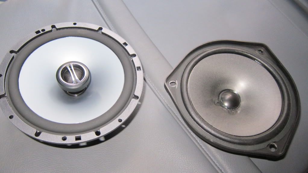

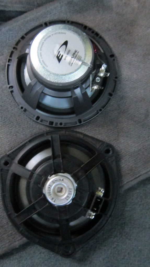

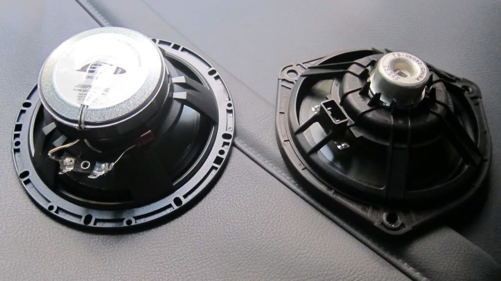

OK SIDE BY SIDE COMPARISON WITH THE CHEAP CHINA SEMBARASSING STOCK

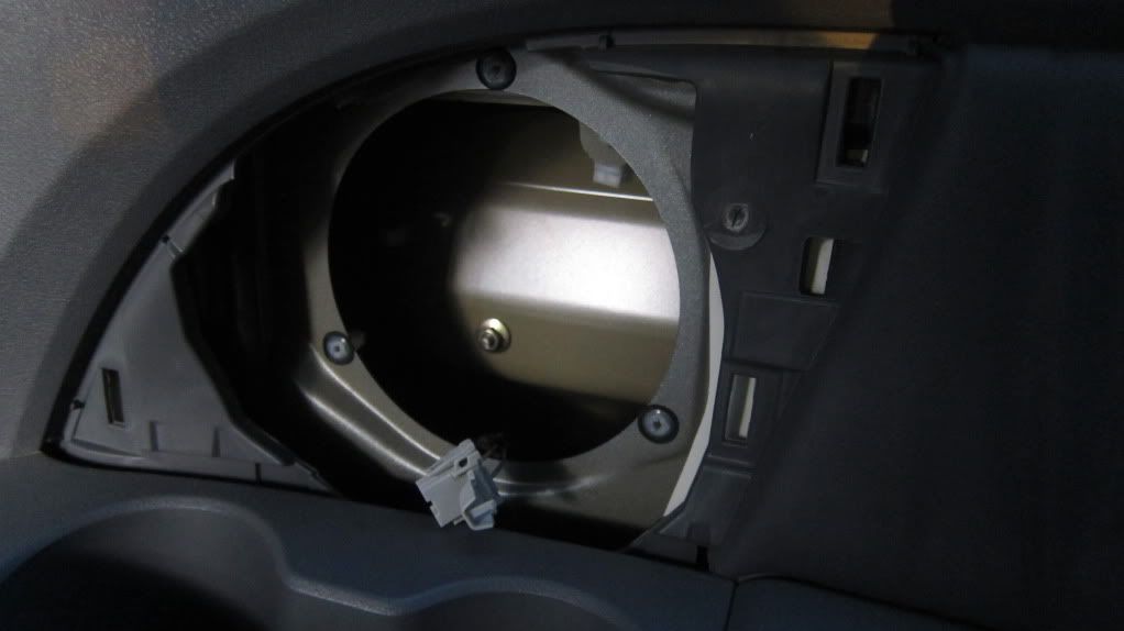

USE A FLAT HEAD SCREW DRIVER TO POP THE REAR SPEAKER MESH COMES OUT EASY
SEE PIC BELOW FOR THE CLIPS LOCATIONS

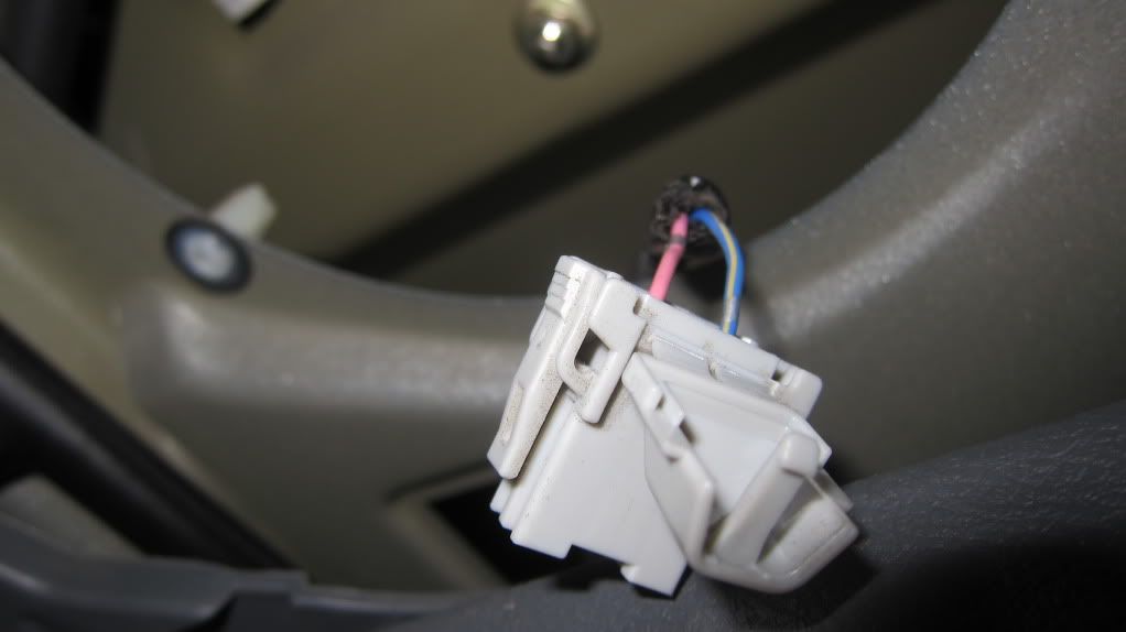

HERE IS THE STOCK SPEAKER CONNECTOR WHICH YOU CAN PURCHASE A PLUG AND PLAY KIT FROM BEST BUY FOR AN ADDITIONAL $14.... I'M GONNA TO CUT THE STOCK CONNNECT AND ADD AN EXTENSION AND THEN USE A SOLDERING IRON
12 Posts
Discussion Starter · #2 ·
CUT THE STOCK SPEAKER CONNECTOR
ADDED 18 GAUGE SPEAKER WIRE THE COPPER ONE IS POSITIVE (+) AND

SPEAKER INSTALLED PERFECT FIT AND USES STOCK HOLES

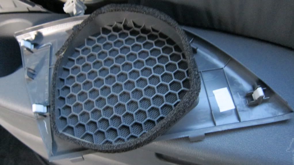

OK TIME TO DO THE FRONT SPEAKERS.............
REMOVE PLASTIC COVER BEHINDE THE DOOR HANDLE FROM INSIDE THE CAR. TWO PHILIP SCREWS... ONE OF THEM YOU HAVE TO HOLD THE DOOR HANDLE TO GET AT IT............
ONE PHILIP EASY SPOTTED
USE SKINNY FLAT HEAD SCREW DRIVER TO PRIDE ALONG THE EDGE OF THE WINDOW MASTER SWITCH
ONE HIDDEN PHILIP SCREW ONCE YOU TAKE OFF THE WINDOW MASTER SWITCH
SIDE MIRROR COVER CAN BE TAKEN OFF WITH FLAT HEAD SCREW DRIVER
COVER --- SEE WHERE THE CLIPS LOCATION ARE
UNBOLT THE STOCK SPEAKERS MAKE SURE YOU CHECK THE WIRING DIAGRAM FOR POSITIVE AND NEGATIVE
