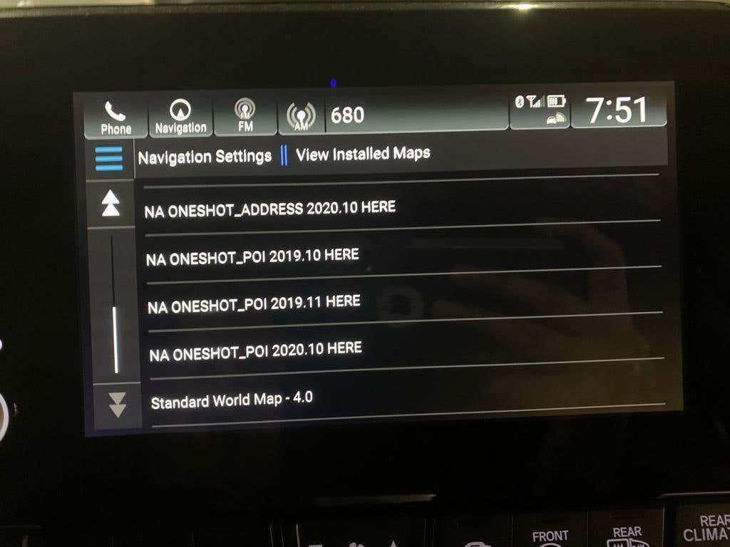

Can someone check their Navigation Settings > Installed Maps screen you see if you see what I see?
My latest maps update failed but it seems like I have 2019 and 2020 maps installed. Is that how you see as well whoever has been able to successfully update the maps to latest version?

What does the maps screen say compared to mine? Do you all have 2019 and 2020 maps showing installed on that screen? Trying to determine if after 2020 maps update, I should still be seeing older maps installed?
My first update failed at 70 something % then each one after at exactly 14%. It looks like I have old and new maps now and the system still says there is update available but it fails at 14% when I try to update with various USBs 32GB and 16GB etc etc.

What did you do differently to make it work? Did you also have two versions of maps installed like me when it was failing?
I bought a new stick 16GB stick, got it FAT32 formatted in windows, put it in the vehicle to get maps into downloaded, plugged into PC/Garmin express to download maps, then put it back in vehicle to install the maps. It still keeps failing. I have tried 32GB, 16GB started from scratch many times with formatting the USB

Not sure it will help you because I'm in Canada, but here is what the map info on my 2018 EX-L Nav looks like. Might be different in the USA. I keep mine updated but don't use it for trips because the ETA is way out of whack. I use my trusty windshield mounted unit instead.
If you haven't tried it, resetting the navigation system might help. Trouble is, you'll loose all your saved information. If you take it to a dealer, chances are that's what they will do.
Discussion starter · #14 ·
Thank you for the screenshots, I am in Canada too so that’s super helpful.
It looks like the 2010 maps got installed Then update failed before the system could confirm that all maps are installed and before it could delete old maps. Now it keeps on saying update available but due to partial new files, the update doesn’t complete beyond 14%. I am going to reset navigation and try. If that doesn’t work Then wait for next update to overwrite existing 2020 data or unless Garmin can give me a file to put on the USB to fix this. (I am in touch with them).
Speed about 1%-2% per minute roughly. I had the van idling, on accessory mode, driving, it always fails at 14% (I guess when it resizes it’s got new files. I wonder if this has something to do with Honda replacing my whole unit last year, maybe they needed to change something else as well or may it’s my USB/pc.
I wonder if anyone else go their navigation system replaced due to it crashing and then tried to update it?
