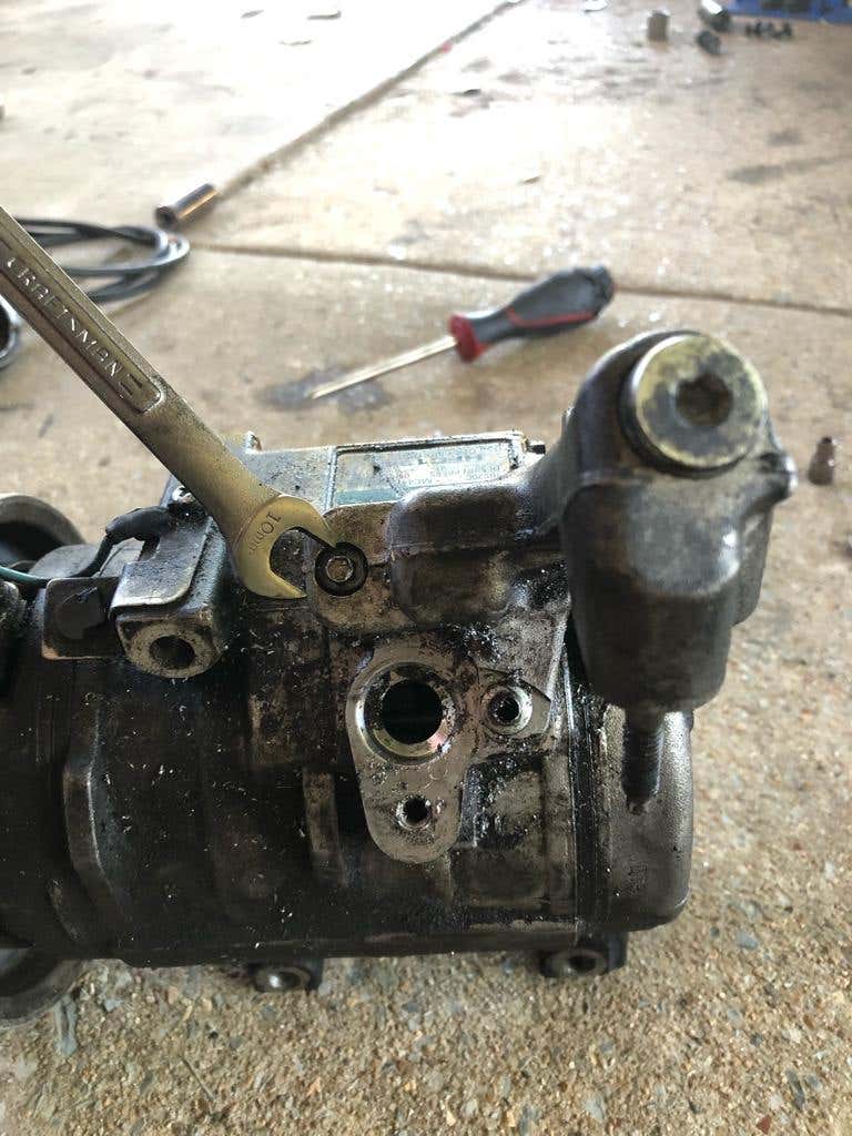

Well, these are stripped! Before I continue with drilling them out, does anyone know the name of this part so I can call around tomorrow if I break this one? I also don’t know how to drill bolts out, I’m just hitting it with every drill bit I can find[emoji2959]
Don't you have a screw extractor kit? Go to a Lowes or Home Depot and pick one up! The better ones include proper sized drill bits for each extractor. You may also want a punch to indent at the center to keep the drill bit from wandering.
Discussion starter · #3 ·
Watching vids on the now. I’m going to Lowe’s too. I’ve never need to extract a bolt. Letting it sit in som PB BLASTER has alway worked for me. Oh well, I guess the worse thing that can happen is that I’ll need to get bigger bolts. I just wanted to know the name of the part should I completely destroy this one. Damn thing took me about 15 min to remove and this is where I get stuck.
I was looking at that grab it pro. Should it fail, I’ll definitely take it back!!
Discussion starter · #6 ·
Honestly, I bought this compressor straight up without a core charge so I’m thinking about going straight piggy bank on the pos and breaking everything around it. First gonna take this oily piece of crap to the dealer, maybe they can name that part. I’m exhausted
?? You sent as a photo of the compressor but you keep asking about a bracket. I don’t think anyone here knows what bracket you are referring to.
Discussion starter · #8 ·
The thing that I’m pointing to. Looks like it connects to the high pressure line. Just spoke with Honda and they said they don’t sell that part separately. I just got the bottom bolt out with pliers but that top bolt isn’t moving. Im looking for my air tools to chisel this thing apart.
Discussion starter · #9 · (Edited)
Got it! But the dremmel slipped. I’m gonna try to get away with patching it up with some JB weld but I feel like this might pose a problem down the road,Hopefully it won’t. I can’t believe this isn’t sold separately! Now to find the damn 8x1.25 bolt, if I’m correct….
