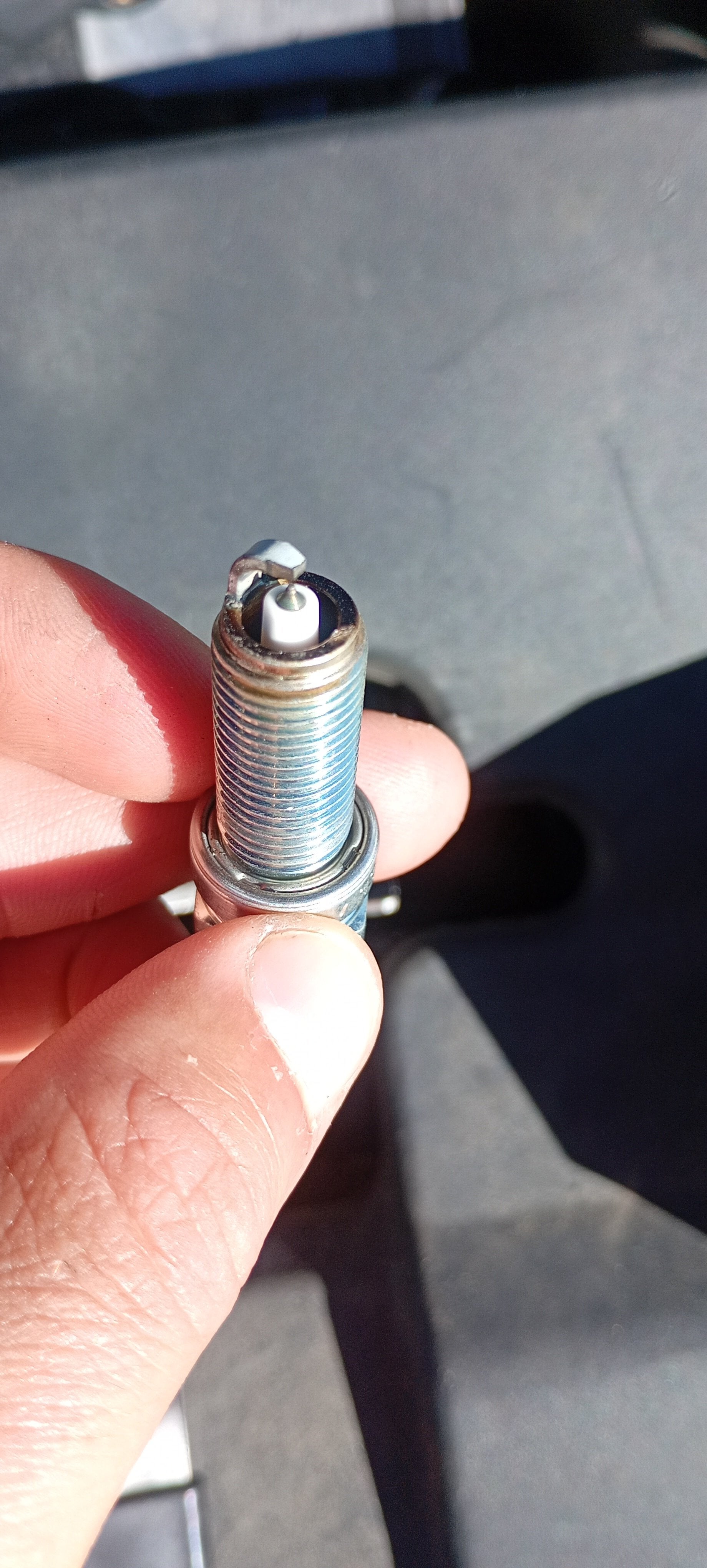

Hey guys I just bought a 2010 Odyssey EX-L 3.5L V6 F SOHC with 177k miles. I kept getting a misfire in cylinder 3 (P0303) so I replaced the spark plug. The problem went away for 200 miles but it's back again and I noticed that the coil is quite dirty (maybe oil? (photos attached below)). It's also wrapped in tape which is concerning.. I pulled out the other coils and plugs and they seem perfectly fine.

Get a new coil or two from a u-pull yard. I'm willing to bet the tape is covering a crack in the tube.
Edit: If you haven't already installed a VCM muzzler you'll want to look into that. There's a great VCM megathread stickied to the top of this 2005-2010 section.
Edit: The brown stuff is old dielectric grease.
