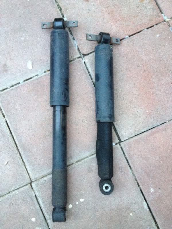

After about 5,000 miles of hearing the rear bottoming out every day I finally changed the rear shocks on my ODY!! Still can't believe that the rear shocks only lasted about 28K/4.5 years. Well here is a pic the as you can see the one to the right (was on the pass side) was the problem child! It wouldn't even contract anymore! I replaced them with Monroe Sensa Trac #37288, got them from Amazon $34.99 each, no tax, free shipping!! Just finished test driving it, just like the day I picked her up! Right now am at 34K miles and 5 years with this van, and I have the extended warranty and I know I could of just taken it in and had it replace under warranty but and am hoping I won't have to use my ext warranty so I can cash it out at the end. But I will most likely use only if something major happens!

I replaced mine with Sensa-Tracs 3 years ago and they are still good. Actually lasted longer than the Honda OEM shocks. Don't notice any difference in ride at all. Been pretty happy with them so far.

I went with sensa trak Monroe as they were available and my last van I used Gabriel air jackers and ride was rough, these ride like stock but with a bit more "gas" to give a little push up. If you could hold both OEM and Monroe you'd see the OEM has about 1/2 the oil (even the non-leaking one) in it and shoddy quality, not that Monroe is anything great. KYB would a performance upgrade I think having had them on another vehicle, generally stiffer. But having done stiff for many years on old van, I wanted a smooth ride.
