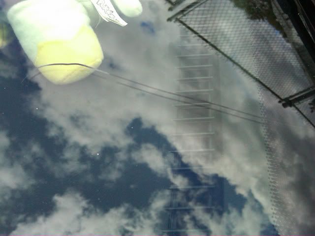

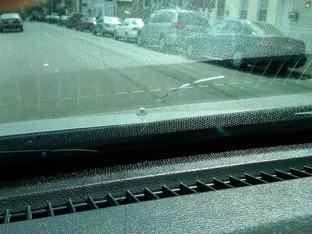

this has never happened to me in the history of me being behind the wheel. i was cleaning the windshield with rain-x, and i put the wipers up. after i was done, i let the wiper go too fast back onto the windshields fixed position and it cracked it.......

I wouldn't recommend any "fix" for a crack in a windshield. The repair stuff is best left for chips and non-fractured scrapes, and is ONLY cosmetic, not a structural fix of any kind.
A crack in a windshield WILL spread in time, and a sudden spread all the way across can lead to additional cracking, shattering or even collapse - often while at freeway speeds. The bigger the windshield, the bigger the likelihood of a catastrophic failure.
IMVHO, a crack in a windshield as big as the Ody's is nothing to fool with. Get it replaced soon.

Are you sure? ALL local glass plases guarantee chip AND crack repair for life and will repair a crack as big as a dollar bill on ANY car including the Oddy. Some of 'em do such a good job that once they're done, you wouldn't even know where the chip was so if they fill their resin (sp??) in the crack, I don't see how/why it would spread and if that was the case, those glass guys would be losing money as if a repair fails they have to replace the windshield for FREE so I gather.

Looking at the picture, it would have to be one big dollar bill... Not sure they can do something, but it wouldn't hurt to have it looked at.

I agree that it is beyond repair. Some Insurance companies might not cover it. It depends on the coverage. I found that out after getting a crack in my windshield.

There is a difference between a chip, a scrape and a crack that doesn't touch an edge, and an edge-based crack. The former can sometimes be fixed (chips and scrapes, almost always), but an edge crack is a disaster waiting to happen. Might be fine for years, but it *will* go sooner or later... and can collect some charming fixit tickets on the way... but if a fix is possible and "good enough," by all means try it. Windshields are expensive...

From the picture, it appears that crack is too big to be repaired. You are most likely going to need new glass.

yeaaa i will get a new one for sure as the crack got bigger on my mini trip to phildadelphia over the weekend.....about 4 inches from where it sort of "hooks" to the right side, the crack grew straight up to 4 inchs straight. darn it.
