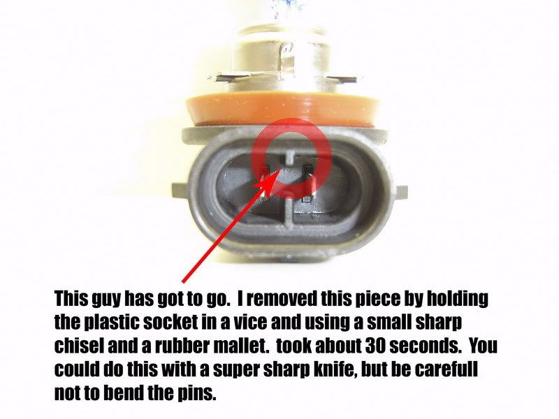

There is a way in which we can improve our headlights lumen. Below is an excerpt from MR. D. stern.
Your low beams take a 1350-lumen H11 bulb. You can easily, safely, and effectively replace this with a 2100-lumen H9 bulb. Use a quality brand of regular standard H9 bulb (Philips, Narva, GE, or Osram-Sylvania) with colorless clear glass. You may need to shave a small ridge of plastic off the H9 bulb's connector so that the H11 socket will snap on. Other than that, it's a direct swap. The only disadvantage is shorter low beam bulb life — the H11 is optimised for very long life with relatively modest light output, while the H9 is optimised for very high output with relatively short life. Note that the H9 swap is not universal; it works well in projector-type low beams but is not safe in most reflector-type low beams or in fog lamps of any type.
I know almost everyone gives a shiver regarding PnP kits-- BUT this one almost puts lumens as equivalent as your Pnp kits..
PS. the excerpt & pics above is from my personal e-mail. Please note that I'm in NO way responsible of any possible damages. you can e-mail daniel stern if you want to double check. I just want to share!
Good luck!

Not True: 1760-2240lm for H9 versus 1100-1400lm for H11. H9 wins every time.

good write up; but y? just go buy brighter h11. standard h11 is brighter than h9 and creates less heat. just buy sylvannia like raistlin, problem solved.

Not to insult anyone, but how can you be so sure it is safe to use a different bulb type modified to fit the connector?

sorry i met to say silverstar h11 is brighter than standard h9. also h9 uses 65 w which it can damage headlight lens over time by creating yellow stain or cloudy lens. have you guys tried sylvannia silverstar zxe? supposedly it's bright as or brighter than aftermarket h9 bulbs.
39 Posts
That might be a good alternitive, they say the zxe is 50% brighter. That would be about 1650-2100 lumens. IF they are telling the truth. I have not found any lumen output specs for them yet.
I just put in H9's and they are great.
