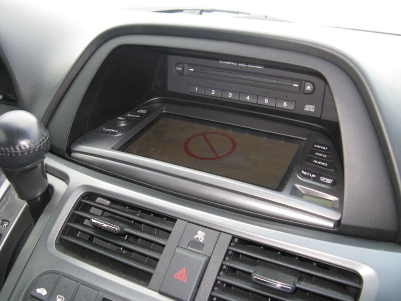

I own an 08 touring and I had the bloody cd jam error.:huh:
After a lot of web surfing here and there I have accumulated a lot of info that I wish to share here. In my case I had 2 cd stack in the same slot.

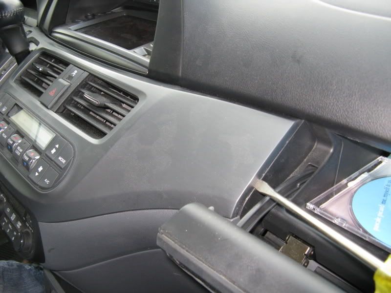

1. Start by with the upper glove box open and with a slotted screwdriver, pry the center dash face outward to get the first clip out of its hole.
2. With fingers, continue to “pry” the dash face outward and not upward (toward the rear of the van). This takes firm pressure. Work your way towards the steering wheel along the top and then back along the bottom.

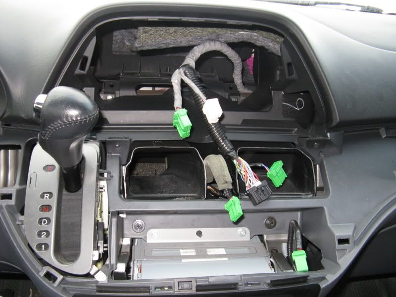

3. Remove the center and passenger side electrical clips from the back of the dash face and swing down and out of the way.

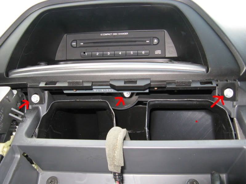

4. Remove the three Phillips screws that hold the NAV/Changer assembly in the dash. I suggest slipping a piece of paper between the NAV assembly and the air vents when removing the center screw so as to not lose it behind the dash.
5. Turn the ignition key ON and with foot on brake, put the trans into L. Remove the NAV/CD assembly (it slides straight out). Put the trans back into P and turn OFF the ignition.

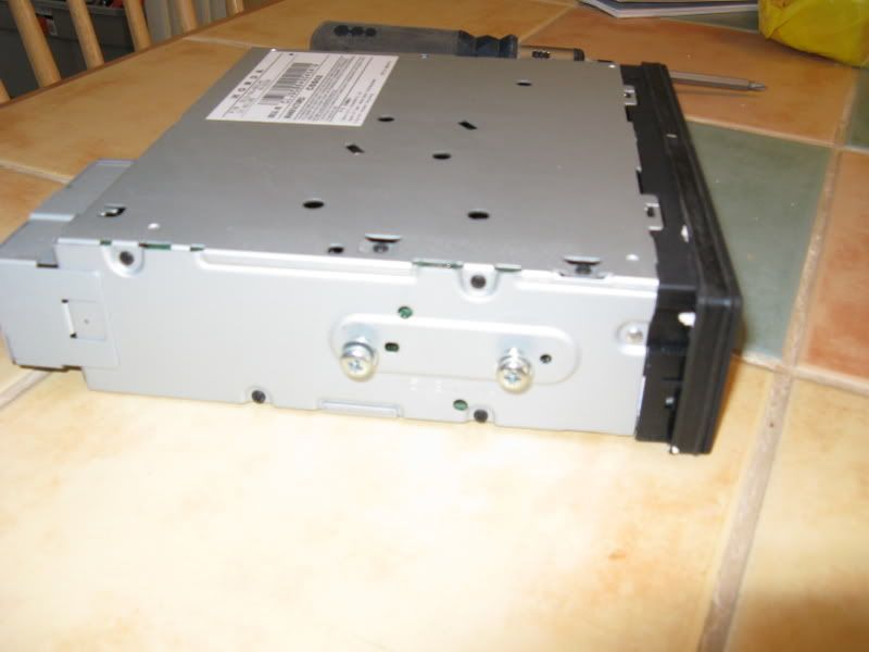

6. Remove the four screws that hold the changer in the assembly and unplug the CD changer white and green connectors from the rear.
7. With the changer on a table, remove the eight small screws that hold the top cover on the changer. Remove / lift the two “pins” that fit into the top rear of the disk carriage (into the two posts that extend from the lower chassis. Insert thin wire into the three springs (one on right and two on left) that hold the disk carriage metal top plate down. The 3 vertical springs have closed loops at each end that hook on small metal tabs. Tape the wire to the side of the changer. This will make it easy to re-hook in place when done.

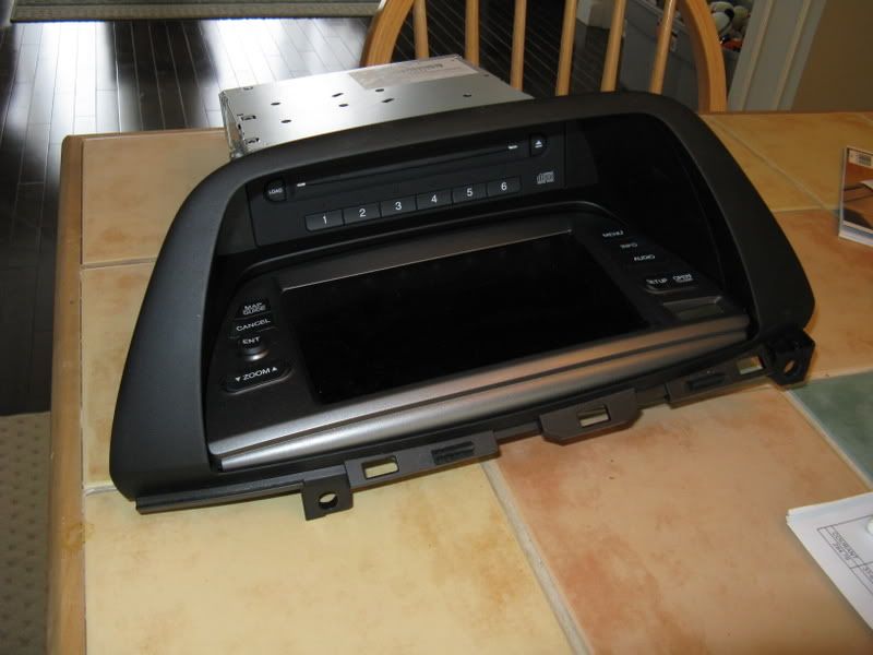

To start, open up the screen to have more acces later
Then, unclip the facia ( special place for screwdriver in the hand trunk)
Remove carefully those 3 silver screws ( you'll need a long bit for the middle one)
Then pull everything out gently and remove the connectors at the back
Once everything secure on the table, removethe cd changer hold by 4 screws ( keep a good pic of the stickers just in case)
