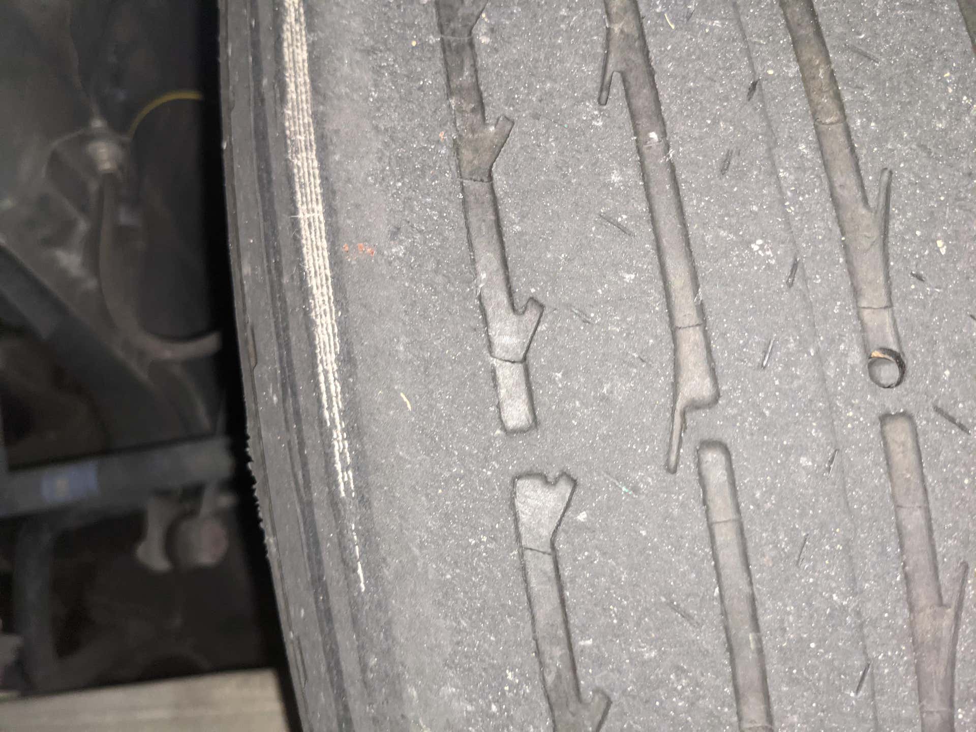

I noticed the inner shoulder of one of my tires has an exposed tire wire due to excessive wear. From the looks of it, it seems like someone up above was looking out for us, since it must have been balding for some time. The photo shows the worst part (longest length of exposed wire), however there are various shorter lengths exposed all the way around the tire.
I'm kind of annoyed that Honda didn't warn me about this when I took it in for an oil change and tire rotation a few weeks ago. It's not immediately obvious, but I just happened to notice it while watching my wife drive up and taking a hard left turn.
Needless to say, it must be replaced pronto. Would Honda give me credit for the tire since it's only 25k miles? I presume this is an alignment issue, which wouldn't be covered under warranty
If the Honda doesn't give me 50% credit for the tire, I'd rather not waste my time going to the dealer. I'd probably go to Costco or somewhere else per recommendations on this forum.
2018 Elite, 25k miles, just under 2 years owned.
Thanks

Call the dealer if for nothing more than to double check, but tires are wear items and and it's highly unlikely you get any kind of help from them. There is obviously an alignment issue, but the center of the tire is past the wear bars also. Alignment I believe is covered only during the first 12mo/12K miles as it is a maintenance item. Others here have reported getting only 25K out of a set of tires, so it's not unheard of.

Yeah I do have them rotated with every oil change.
This (front driver side) is the only tire that's worn down to the wear indicator. The front passenger side is also worn almost down to the wear indicator, and it doesn't have any exposed wires.
Rear tires are in much better shape. But I am going to replace all 4 anyway. Before I do that I feel like I need to figure out the culprit for excessive wear on one tire.

So here is the issue. Blanket rotation schedules simply do not take into consideration your personal driving habits, mile type, and your geographical location. In the mid west with about a 50/50 local/highway mile mix and a wife that drives gently I have never gotten less than 50K out of a set of tires and that's not even running them below 5/32 which I refuse to do. But my buddy who lives in the southwest US where the pavement formula uses a much different type of stone and percentage of stone mixture to deal with the heat can never seem to get much past 20K. Lots of local miles vs highway, but not an aggressive driver. When he first relocated he asked me what he was doing wrong because it was so different than what he was used to. Also, the Ody is very heavy and drivers coming from small to medium sedans that still drive the same way go through tires and brakes pretty quick.
If I encountered you at the tire store counter I would ask the questions above and make a recommendation based on that, but I would focus on tires that were designed specifically for the crossover or suv market as they are designed for heavier vehicles and tend to hold up better on the Ody. I would also watch the load rating and try to stay with a 105 rated tire. One extremely good choice for the money in the 235/55-19 size is the Sumitomo HTR A/S P03. I have a set of the previous P02 model on my 2011 Toyota Venza and they are holding up great. The also do very well in snow and wet and are about $50 a tire less than pretty much any comparable tire.

If your front tires are clearly worn more than the rear ones, the tires weren't rotated frequently enough. Or, the dealer might not have rotated them and you thought they did. I'm thinking they didn't rotate the tires, otherwise they definitely would have seen and told you that you needed new tires.
Highly unlikely the dealer will do anything for you about the tires. 25K miles is on the low end of what people get out of a set of tires, but definitely not unheard of, especially on the factory set that tends to be more cheaply made. Odd that the alignment would be THAT far off by 25K miles. Perhaps you or your wife make an unusually frequent amount of left turns, at a high rate of speed?

At 25K, you are past your wear indicators and that tire is looking at significant negative camber. Since camber is not adjustable on the G5 from factory, and there are no solutions to fix them (yet), you need to really isolate what is wrong with your suspension that is causing this type of wear. I believe there is some significant misalignment (to say the least) and probably due to impact or component failure.
My recommendation is before you take it to a shop to get tires installed, ensure that your suspension is healthy.

I was wondering if OP might have hit something really hard like a curb, or if the vehicle had been involved in an accident at one point. I agree that there is something really off about the suspension that I don't know if a simple alignment would correct.

Next step is to get the suspension checked. This vehicle has not been in an accident, nor has it hit a curb. Hopefully it's component failure that can be covered under warranty.

I noticed the inner shoulder of one of my tires has an exposed tire wire due to excessive wear. From the looks of it, it seems like someone up above was looking out for us, since it must have been balding for some time. The photo shows the worst part (longest length of exposed wire), however there are various shorter lengths exposed all the way around the tire. I'm kind of annoyed that Honda didn't warn me about this when I took it in for an oil change and tire rotation a few weeks ago. It's not immediately obvious, but I just happened to notice it while watching my wife drive up and taking a hard left turn. Needless to say, it must be replaced pronto. Would Honda give me credit for the tire since it's only 25k miles? I presume this is an alignment issue, which wouldn't be covered under warranty If the Honda doesn't give me 50% credit for the tire, I'd rather not waste my time going to the dealer. I'd probably go to Costco or somewhere else per recommendations on this forum. 2018 Elite, 25k miles, just under 2 years owned. Thanks
Sent from my Pixel 4 using Tapatalk
Did you get any resolution with this? I have a 2020 elite doing the same exact thing since I purchased it. 3rd set of tires. Alignment is fine but tires wear heavily on the inside of the tire.
